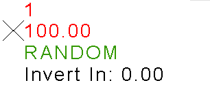

- In the text editing window, delete the text “Label Text” from the label. Enter Invert In: before the property field, which is enclosed in angle brackets(<>). The text in the editor should look like this:
- Click OK.
In the preview pane, your label should look like this:
