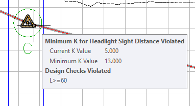

  3. Hover the cursor over the symbol in Circle C.
    The tooltips are a convenient way to review design criteria violations in the drawing window. Two violations are displayed in the tooltip:
    • First, the curve does not meet the recommended minimum K value for headlight sight distance. The curve K value and minimum acceptable K value are both displayed.
    • Second, the curve does not meet the formula specified in one of the design checks. Notice that the name of the design check is displayed, but not the current or recommended values. Values are not displayed because design checks are custom formulas that are created by the user.

  9. In the Profile Elements vista, click row No. 4, which is the curve element in Circle C.
    The design data for the curve element is displayed in a three-column table in the Profile Layout Parameters window, where data is easy to review and edit.
    Notice that in the Profile Layout Parameters window, in the Design Criteria panel, a symbol is displayed next to the design criteria property that has been violated. In the Layout Parameters panel, the Value column displays the actual parameters of each sub-element. The Constraints column displays the design criteria values that the sub-elements must meet. A symbol is displayed next to the K Value row because the value violates the design criteria. As is true in the drawing window and Profile Elements Vista, the design check that has been violated is displayed, but individual parameters that violate the check are not marked.
