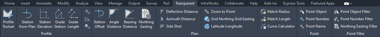

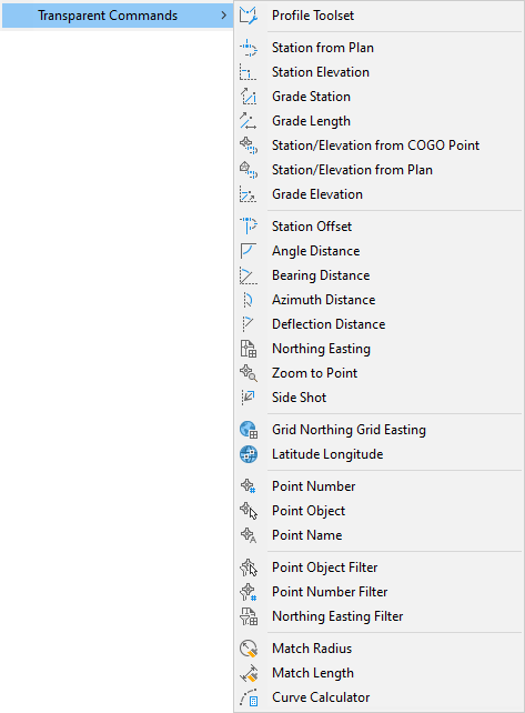

You can run transparent commands from the Transparent ribbon tab, from the context menu, by using a toolbar or by entering a command.
