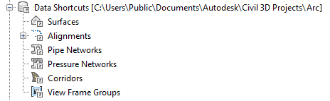

Shortcut project template: the Prospector tree icons
Shortcut project template: the working folder

The path to the current data shortcuts folder (also known as the project folder) is specified on the Data Shortcuts node in Toolspace, on the Prospector tab.
The project folder typically contains both the data shortcuts and the source objects for data references.
Data references that you create in the active drawing come from the active project folder.
