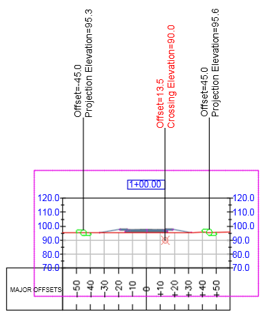

You can visualise the location of objects in relation to section views by adding projections and crossings to the section views.
The following illustration shows projections on either side of the corridor at the existing ground level and one crossing below ground level.

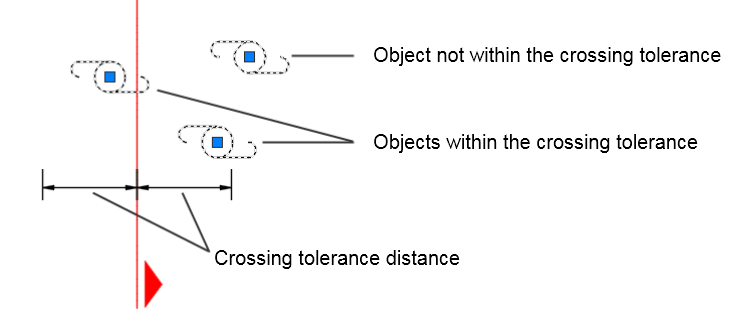

A non-linear object such as a block is considered to be crossing a sample line if its centroid grip crosses the sample line, or is within the crossing tolerance.
You can specify a crossing tolerance value in the Edit Feature Settings – Section Views dialog box to control how close the centroid grip of an object can be to the sample line in order for it to be considered as crossing it.
