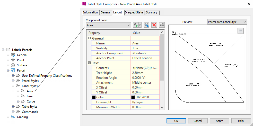

Plot area labels appear in the drawing as they appear in the preview of the Label Style Composer
You can create and save label sets for alignments, profiles, and sections, which allows you to apply multiple label types in one operation. For example, an alignment label set could include labels for major chainages, minor chainages, and geometry points.
Labels can include text, blocks, lines, ticks, and leaders. You can create labels and preview their appearance in the Label Style Composer dialog box, as shown in the following illustration:
Previewing customized label style for plot area

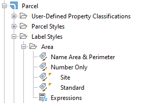

In the Toolspace Settings tree, Label Styles collections contain one or more types of label styles that represent a unique aspect of the object using it. The following illustration shows the hierarchy of the label style collection, the label style types, and the individual label styles:
Plot Area label style type collection
Each label type has a Standard label style. The Autodesk Civil 3D drawing templates also contain several other label styles you can use.
