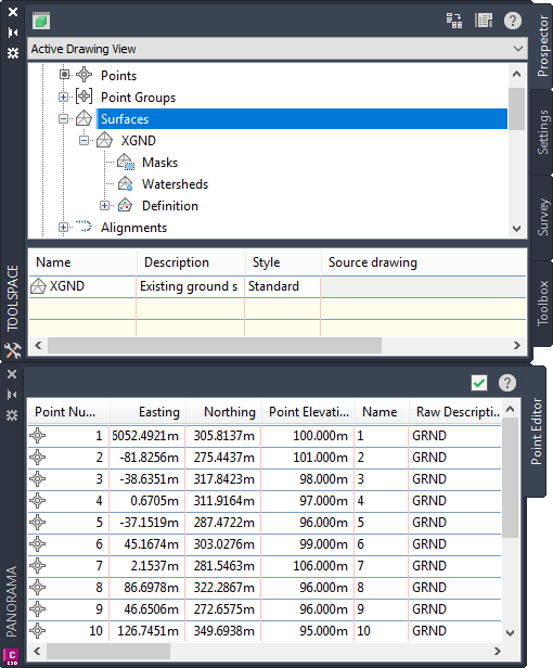

The Toolspace and the Panorama windows share several features.

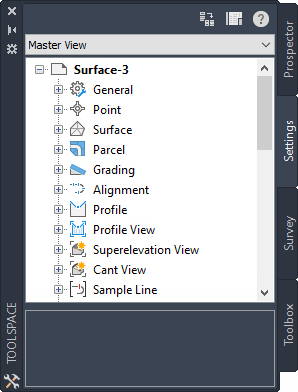

The Toolspace window can display up to four tabs: Prospector, Settings, Survey, and Toolbox. The Panorama window displays named tabs if you have more than one vista active in the window.
Right-click in the Toolspace or the Panorama window to display a context menu of available commands. Right-click a single item, or select one or more items and right-click, to display a menu containing commands related to the item(s). If you right-click an area that contains no items or data, the menu contains commands related to the window.
