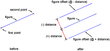

You can offset an existing figure by a specified distance. A positive value indicates an offset to the right; a negative value indicates an offset to the left.

The following illustrates the Offset Figure command:
OFFSET [figure] [distance]

| figure | The name of the figure you want to extend. |
| distance | The offset distance from the current point. Enter this value in the current survey database distance units. |
