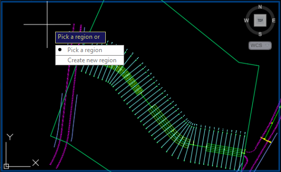

You can assign lane inputs and properties and edit rehab input parameters in the properties table.
 Click Rehab Parameters
		 to launch the Rehab Parameters palette if it's not displayed.
For each selected chainage, you can modify parameters in the Rehab Parameters palette. Changes that you make in the Rehab Parameters palette will update the selected rehab corridor region and the cross section view once you click Apply.
 in the Rehab Corridor Editor ribbon tab.
	 The currently selected rehab corridor region is automatically assigned to the Rehab Manager.
By default, the Crossfall Correction Report tab is selected in the Rehab Manager. You can also select the Milling and Levelling Report tab. See To Generate Rehab Reports for more information.
