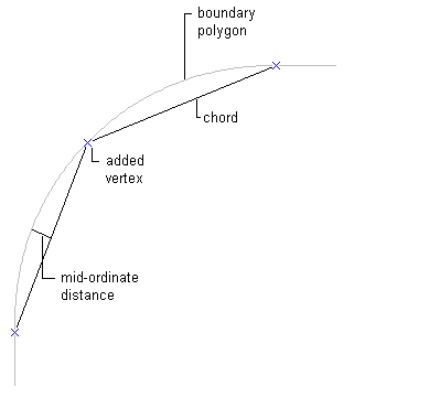

When you use polygons/polylines that contain curves for boundaries or breaklines, set the mid-ordinate distance of the chord segments, which is used to tessellate the arc segments of the boundary polygon/polyline:

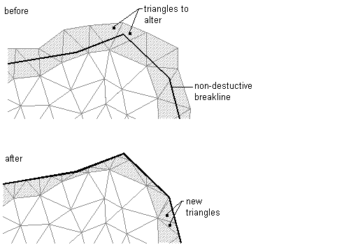

When you create a boundary with non-destructive breaklines along the edges of the boundary, the triangle edges are clipped exactly where they cross the boundary:

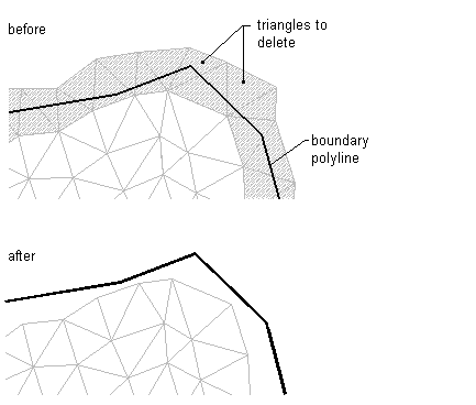

If you create a boundary without non-destructive breaklines along the boundary edges, only triangles that are completely within or outside the boundary are affected:
