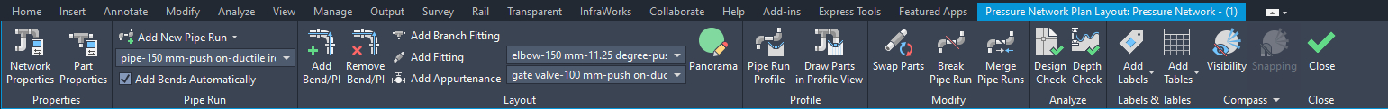

Lay out a pressure network along a path. You can optionally choose to create the pressure network so that it conforms to the topography of a surface.
Pipe Network
Pressure Network Creation Tools
You are prompted at the command line to specify the first point or enter a level.
Add Bends Automatically to include a bend fitting at each segment connection.
Visibility
to turn on the compass guide for allowable deflection angles. Click Snapping
to snap to the compass tick marks when laying out the pipe run.
After you select two points to insert the first pressure pipe, the compass appears and displays the angles of bends in the parts list that match the selected size and material.
