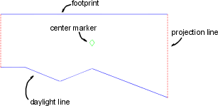

A grading normally consists of the footprint, the daylight line, the projection lines and the face.
The footprint can be an open or closed figure. The footprint must be either a feature line, a lot line or the resulting daylight line of another grading.
The face is the area bounded by the lines that define the grading. It is marked with a centre marker.

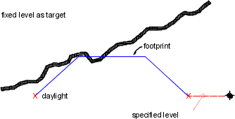

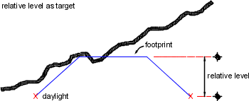

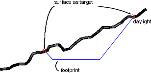

The target for the grading can be a surface, a distance, a level or a relative level.
