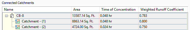

This tab lists the catchments that reference the structure.
Displays the catchments that are connected to the structure.
If no catchments are connected to the structure, you can enter catchment values directly into the Area, Time of Concentration and Weighted Runoff Coefficient fields.
Displays the name of the current structure and each catchment connected to it.
Displays the area of each catchment and the total area of the connected catchments.
Displays the time of concentration of each catchment and the longest time of concentration for all of the connected catchments.
Displays the runoff coefficient of each catchment and the weighted runoff coefficient for all of the connected catchments.
