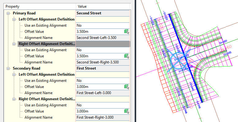

Object Highlighting in Drawing: When you select some items on a junction editing dialog box, the affected object is highlighted in the drawing. For example, when you select an offset on the Junction Offset Parameters dialog box, that offset alignment is highlighted in the drawing. This behavior is displayed in the following illustration.
The right side offset alignment is selected in the Intersection Offset Parameters dialog box, shown on the left. In the drawing, that offset alignment is highlighted.

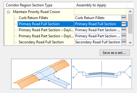

For example, when you select the “Primary Road Full Section” corridor region on the Intersection Corridor Regions dialog box, the following conceptual graphic is displayed, indicating the location of this region along the corridor.

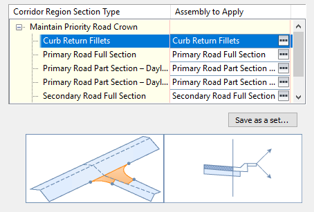

Similarly, when you select the “Corner Radius Fillets” corridor region, the following conceptual graphic is displayed.

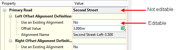

Shading of Non-editable Properties: In editing dialog boxes, properties that are not editable are displayed with a gray (shaded) background color. Properties that are editable are displayed with a white (not shaded) background color.
