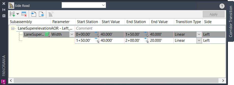

Use the Corridor Transition Panorama vista for creating and editing corridor transitions.
When you select the Edit Corridor Transition command, the Corridor Transition Panorama vista is displayed, and a prompt is displayed at the command line to select the subassembly to transition.
Use the command line prompts to select which subassembly to transition and which parameter to transition, then select stations, values and transition type.
You can also specify values in the Corridor Transition Panorama vista.
When you select a row in the Panorama vista, the corresponding transition is highlighted with blue symbols in the drawing.
Several different transition types are available to create.
