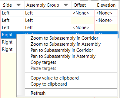

Displays the side of the assembly that the subassembly is attached to.
Displays the name of the assembly group.
Specifies the offset or width targets. Click in a cell in this column to display the Set Offset Targets controls at the bottom of the dialog box.
Specifies the elevation or slope targets. Click in a cell in this column to display the Set Elevation Targets controls at the bottom of the dialog box.

The properties table contains the following columns:
Lists targets that are required by the corridor’s subassemblies, categorized into three groups: Surfaces, Width Or Offset Targets, and Slope Or Level Targets.
Opens either the Pick A Surface, Set Width Or Offset Target, Set Slope Or Elevation Target or Select Pipe Network dialog box, where you can select the Autodesk Civil 3D object name to map to the subassembly target.
Displays the name of the subassembly that requires the target.
