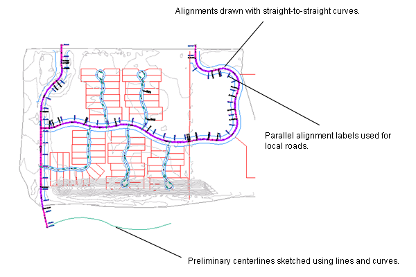

Alignment lines, curves, and labels

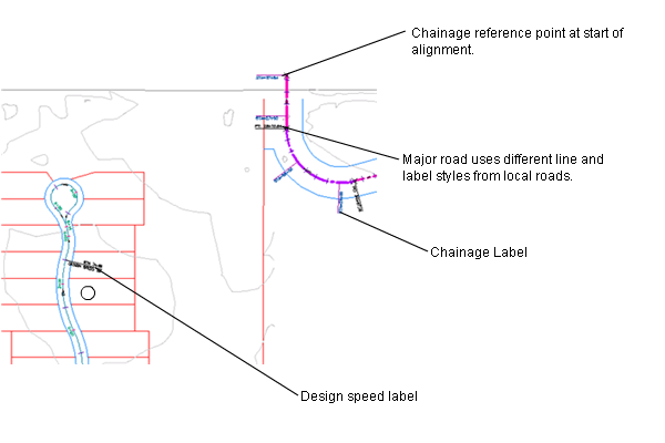

Examples of alignment labels
