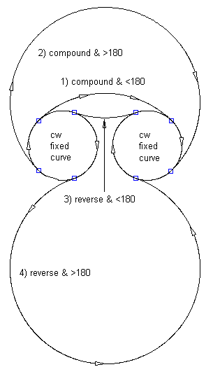

The following illustration shows a free curve fillet between two fixed clockwise curves:

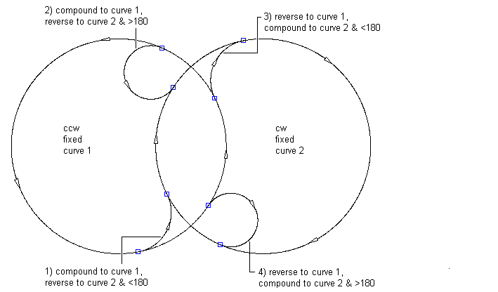

The following illustration shows a free curve fillet between an overlapping clockwise curve and a counter-clockwise curve:

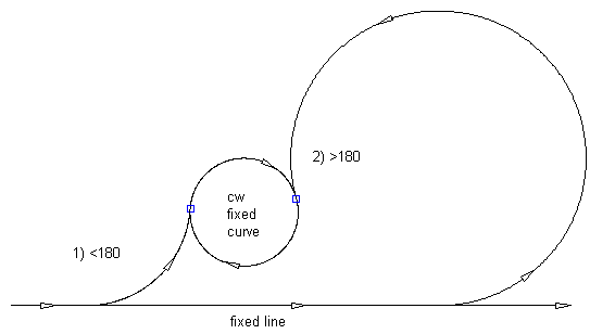

The following illustration shows a free curve fillet between a line and a clockwise curve (on the left) with a specified radius:

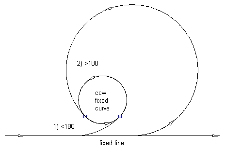

The following illustration shows a free curve fillet between a line and a counter-clockwise curve (on the left) with a specified radius:
