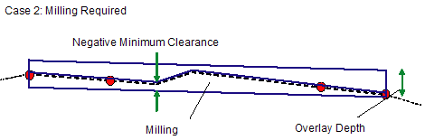

The corridor from which this report is generated must have been created using one of the milling subassemblies. Autodesk Civil 3D scans the corridor for chainages at which milling occurs, the width of milling across the corridor, and the milling area, which is the area below the existing ground surface and above the subassembly overlay.
The milling report identifies the begin and end chainages where milling occurs; left and right offsets from the centerline at the begin and end chainages; and the area that is calculated from the previous data.
