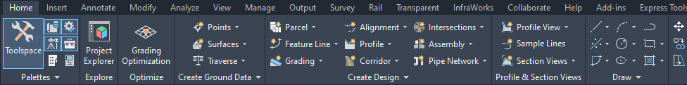

The Autodesk Civil 3D ribbon is the primary user interface for accessing commands and features.
Commands available from the ribbon are organized into tabs. Each tab is organized into a series of panels.
The ribbon is typically turned on (displayed) by default, and can be displayed or turned off by using the Ribbon and RibbonClose commands.

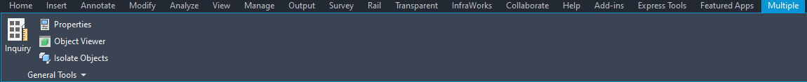

When multiple types of objects are selected simultaneously, the Multiple contextual tab is displayed in the ribbon. For example, if you select both a pipe network object and an alignment object, the Multiple contextual tab is displayed.
