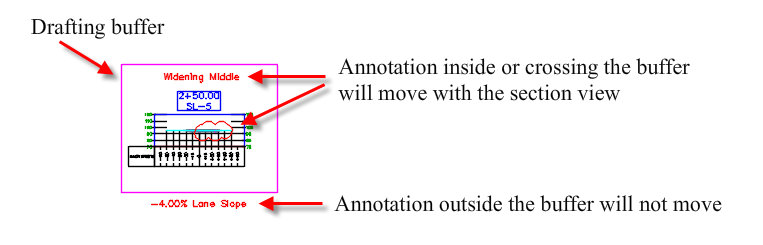

Section views are created with drafting buffers. When you add AutoCAD annotation or drafting elements or Autodesk Civil 3D note labels within or crossing the drafting buffers, they're bound with the section views and are moved with the section views if they're moved.
In the following illustration, the drafting buffers around the section views are shown in magenta. Drafting elements that were added to the sheet are shown in red.
When the section views for chainage 2+50 and 3+00 are moved up or off the sheet, the drafting elements that are inside the drafting buffers are moved with the section views. The text that notes the lane slope is not moved because it was outside the drafting buffer area.
