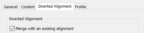

When you create a turnout, you can use an option on the Diverted Alignment tab of the Create Turnout dialog box to merge the turnout's diverted alignment with an existing alignment.
Likewise, on the Profile tab, you can select an option to merge the diverted alignment's profile with an existing profile.
