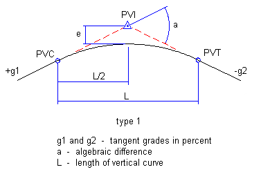

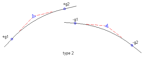

Layout profiles use two types of curves: crest curves and sag curves. Crest curves are placed on hilltops or wherever the gradient changes to a lesser value. There are three types of crest curves: a positive to negative gradient transition, positive to positive, and negative to negative:

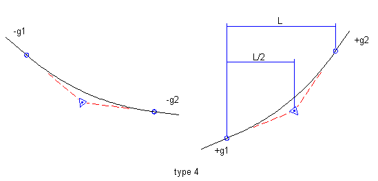

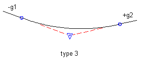

Sag curves are placed in valleys or wherever the gradient changes to a greater value. There are three types of sag curves: a negative to positive gradient transition, negative to negative, and positive to positive:
