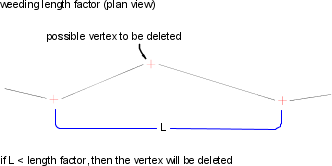

Select one or more weeding factor to apply. Larger values remove more points. If more than one factor is specified, both factors have to be met before the point is selected for weeding.
When you change a value, the display in the drawing is updated with red glyphs to show the points that will be weeded.

Specifies the weeding distance. Enter the distance value or click
to select it in the drawing.
