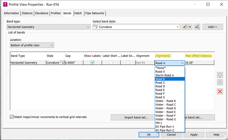

Additional cant profile band information can now be displayed for a secondary alignment:
  • Added an Alignment2 property to display information for a secondary alignment in the cant band.
  • Added a Max Offset Distance property as a range to limit a secondary alignment displayed in the cant band.

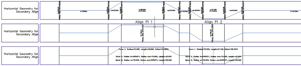

  • Added the ability to label the Cant Critical Station in the cant band.
    See Layout Tab (Label Style Composer Dialogue Box) for more information on editing label components.
  • Added the ability to add diagrams and ticks for Cant Critical Points and Alignment Critical points in the band.
  • Added the ability to add diagrams for Applied Cant and Equilibrium Cant in the band.
  • Added the ability to label projected stations of the primary alignment in the cant band.
    • Primary alignment mapped station - start
    • Primary Alignment Mapped Raw Station -– Start
  • Added API support for the updated secondary alignment band workflows.
For more information, see To Add Data Bands to a Profile View.
