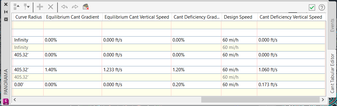

- To facilitate the work of rail designers in the UK and France and meet their design standards, Grade/Slope in Ambient Settings now has (run) and (mm per m, mm/m) formats for cant gradient parameters in the Cant Tabular Editor.

- Added new cant parameters for horizontal alignment in the Cant Tabular Editor for cant calculations. This provides an overview of the necessary parameters in rail design related to such calculations.
- Cant Jerk (m/s^3 or ft/s^3)
- Cant Ratio
For more information, see Cant Tabular Editor Dialog Box.
