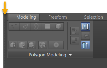

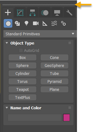

Any element of the interface that has a handle can be floated and docked. The handle can be on the top or left of the element.
To float an element, click-and-drag the handle. As you move the element around the screen, the highlighted areas show valid docking locations. To dock the element, drop it on a highlighted area.

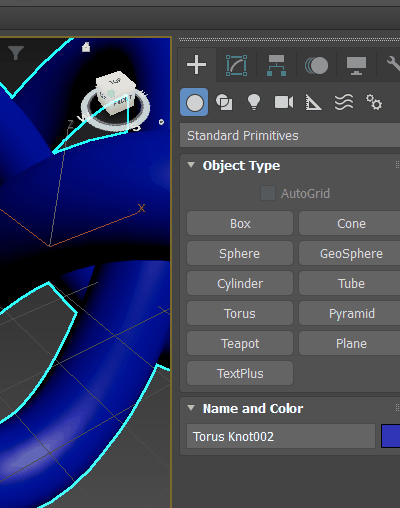

To stack windows
Windows can be stacked adjacent to one another. To stack a window, drop it onto a vertical or horizontal edge next to or between existing panels.
Stacking the Scene Explorer on top of the Command Panel

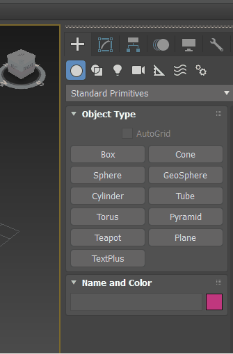

Restoring docked elements
Returning an undocked element to its original position
Double-click the handle to undock an element and restore it to the previous size (and location). When you drag an undocked dialog, it retains its current size.
