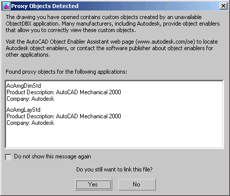

When you use the File Link Manager to Attach a DWG file to your scene, you might encounter a Proxy Objects Detected dialog. This means there are custom objects in the drawing that require special Object Enablers before you can edit the objects in 3ds Max.
Object enablers can be downloaded from the Autodesk Knowledge Network.
