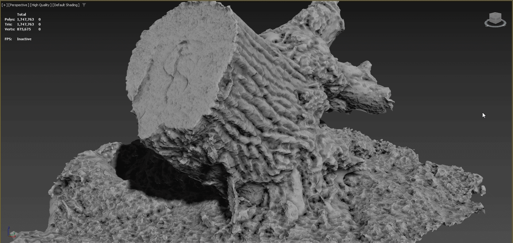

The Preprocess Mesh option, introduced in Retopology Tools v1.2, reduces the need to prepare and configure meshes for retopology when using the ReForm algorithm. This is due to the retopology modifier algorithm creating an intermediary triangle-based Remeshed Mesh that is used as a foundation to build the final quad Retopology Mesh.
However, there may be circumstances for artists to choose to retopologize a mesh with ReForm, without using Preprocess Mesh. In this case, a form of best practice is to ensure that the input mesh contains uniform, equally-distributed faces. Here, it is also best to ensure the polygon count of the object is less than 200,000 in order to achieve algorithm results in a reasonable amount of time. A number of modifiers are available that can help optimize the mesh before beginning the operation or if you encounter areas after computing that are still not desirable.

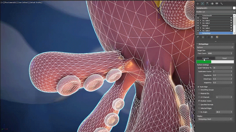

- Relax: The ReForm algorithm is tuned to produce a topology output that is as accurate to the input mesh as possible. Due to this, if you are attempting to retopologize a mesh with lots of noise or high frequency data, this can result in a longer retopology operation. To aid the retopology process, applying a Relax Modifier with volume preservation active and a few iterations applied, before the Retopology modifier can help speed up the process. This will reduce the surface noise without hindering the integrity of the input mesh.
