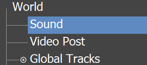

Add sound files to your scene:
(Curve Editor (Open)).
Dope Sheet.
(Edit Keys) is not already active, click to make it active.
3ds Max opens the ProSound dialog.

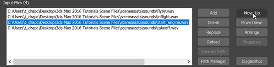

Input Files group, click Add.
The Open dialog automatically opens to the \sounds folder in your active project folder. If the sound files flyby.wav, inflight.wav, start_engine.wav, and takeoff.wav are not there, navigate to the folder where you saved your ProSound tutorial scene files.
The files display as a list in the Input Files group. While it is not mandatory, it can be helpful to place the files in the order in which their sounds are heard in the sound track.

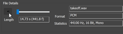

The File Details group also contains options that let you control how the file plays back in the scene. You can, for example, loop the file so it repeats a specified number of times, or enter the first and last frame on which the sound is played. The Active option lets you include or exclude the sound file in the playback.
In this tutorial, however, you will set these and other file playback parameters in a more visual way by using the Dope Sheet.

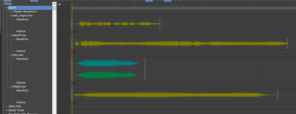

View the sound tracks in the Dope Sheet:
A waveform is an image that represents an audio signal, showing changes in amplitude over time. Soft sounds, like footsteps, produce a narrow pattern, whereas sharp sounds, like the scrape of a chair leg, show a wider pattern. Waveforms help you visualize the events in an audio recording.
The Master Waveform track provides a visual compilation of all tracks.
The first, second, and fourth sound tracks were recorded in mono and show a single waveform. The third sound track, flyby.wav, was recorded in stereo and displays two waveforms, one for its left and another for its right channel.
The segments overlap and produce a jumbled sound. You need to adjust the timing so each plays back at a more logical place in the animation.

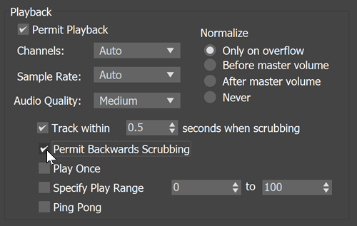

Try scrubbing sounds in reverse:
By default, the audio plays forward as you play the animation forward: There is no audio when you scrub animation in reverse.
Playback group, turn on Permit Backwards Scrubbing.
Now you can hear all audio in the scene play in reverse.
