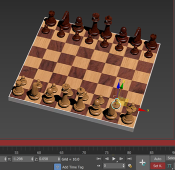

Move the queen using the corners of the XY transform gizmo.
Let’s say you realize you need this pose to happen at frame 60, not frame 55. Here’s what you do.
Now you are at frame 60, and the queen hasn’t jumped back to the previous position.
(Set Keys) or press
K to set a key.
