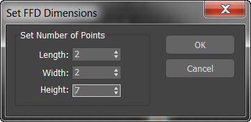

Object-Space Modifiers section, choose FFD(box). Free-Form Deformation ("FFD") modifiers surround the selected geometry with an adjustable lattice box.
Dimensions group, click Set Number Of Points.
This lets you select and manipulate the lattice control points you defined in the previous step.
