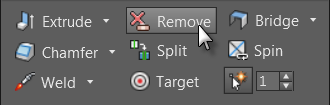

(Remove).

(Remove).
Ctrl+Remove removes the vertices as well as the edges.

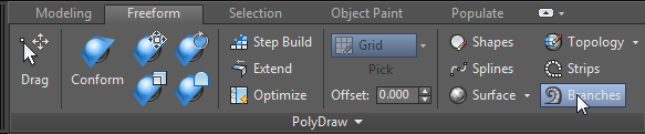

Create irregular spikes using the Freeform tools:
Polygon Modeling panel, activate
(Polygon).
Select the polygon at the base of the ridge.
(Branches).
Helmet after first Branch extrusion
As you progress along the helmet, make sure you maintain an oblique view of the polygons. If you don’t like the shape of an extrusion, or you extrude the wrong polygon, press Ctrl+Z to undo the operation.
