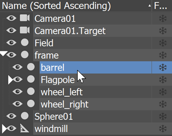

(Select And Move), then hover your mouse over the rear portion of the cannon.
After a moment, a tooltip appears that says frame, which indicates your selection tool is hovering over the frame object. In this scene, the frame is the parent object of the cannon; meaning that if the frame moves, the rest of the cannon assembly moves with it.

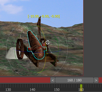

and advance to frame 160.
(Select And Rotate).
As you modify the barrel rotation, the axis values update in yellow.
