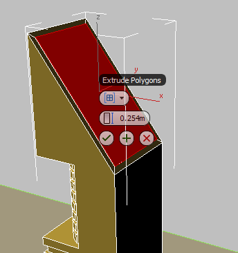

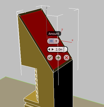

Add an inset to the roof:
(Polygon), then
3ds Max displays the caddy controls for the Inset tool.
The inset operation creates a polygon two meters smaller in the X and Y dimensions, centered on the original polygon. You can now extrude this newly created polygon.
Settings button next to Extrude.
3ds Max displays the caddy controls for the Extrude tool.
