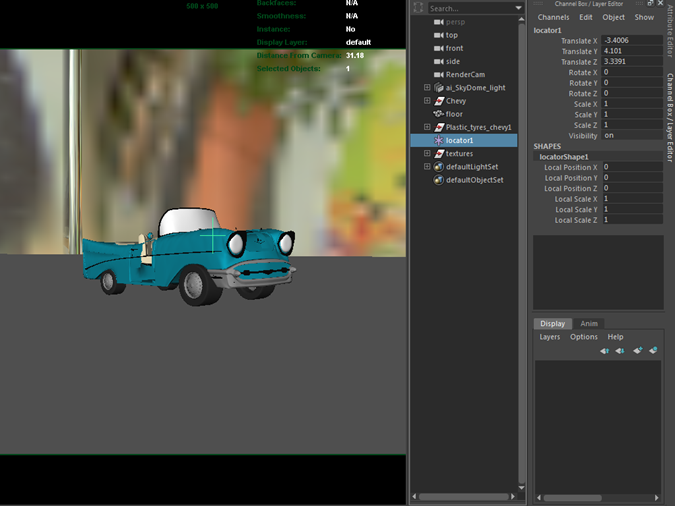

Create a locator and position it where you want the focus distance
Set the Focus Distance to be the same as the Distance from Camera for the locator
