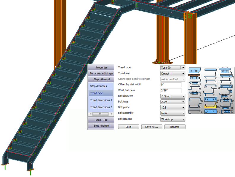

Create complex structures such as straight and spiral stairs, railings and cage ladders.
Example: Create a straight stair between two points
- On the Home tab
Extended Modeling panel, click
(Straight stair).
- Choose a method to define the stair size (Start and end point, Length and angle, or Height and angle).
- Select the points and enter the values based on the selected method to create the stair.
The stair is created and you can modify its properties in the dialog.
