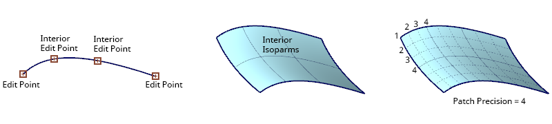

To create a curve by placing edit points:
  • New Edit Point Curve
    New curves are created with edit points displayed by default. New surfaces are created with interior isoparms displayed by default.
To select edit points on Curves and on Curves-on-Surface, they must first be displayed using Display > Control

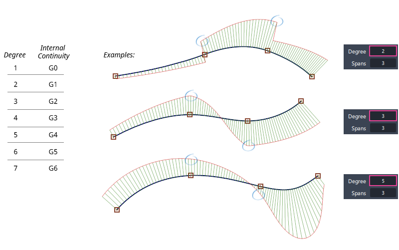

Deep dive: Internal continuity for multi-span geometry
When building multi-span curves or surfaces, the internal continuity achieved across a span boundary, such as edit point or isoparm, is determined by the degree of the curve or surface.
