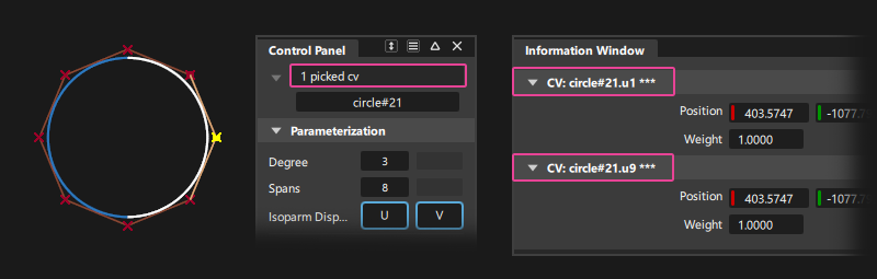

Deep dive: CVs on periodic geometry
Periodic geometry has some CVs that appear to be double CVs in the Information Window, but this is only a technical representation.
In all selection and modeling situations, these are treated as single CVs.
