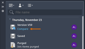

Compare Different Versions
When you use Activity Insights with a supported cloud storage provider, you can easily compare previous and current versions.
