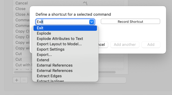

    The visor displays.

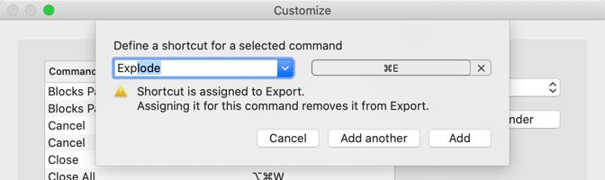

  2. Start typing the command name you want to assign the shortcut key to. Select the command from the drop-down list.
  3. Click Record Shortcut.
  4. Press the keys you want to assign to the command.
    Note: If the shortcut keys are already assigned to another command, an alert displays indicating which command uses the shortcuts keys.
