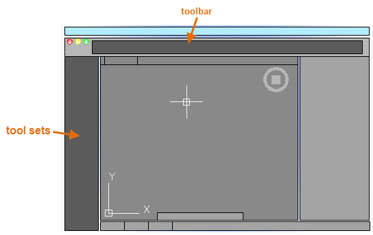

AutoCAD includes a tool set to the left of the drawing area. You can access nearly all the commands presented in this guide from the Drafting tab. In addition, the toolbar above the drawing area includes familiar commands such as New, Open, Save, Print, Undo, and so on.

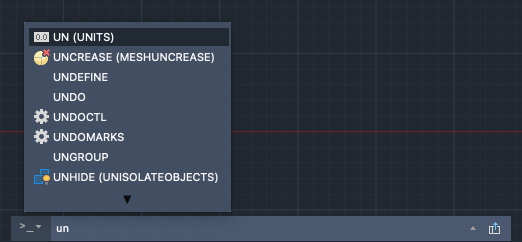

Notice that as you start to type a command, it completes automatically. When several possibilities are available such as in the example below, you can make your choice by clicking it or using the arrow keys and then pressing Enter or the Spacebar.

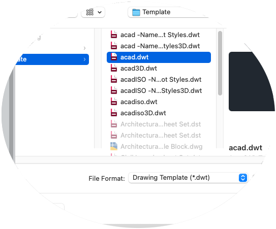

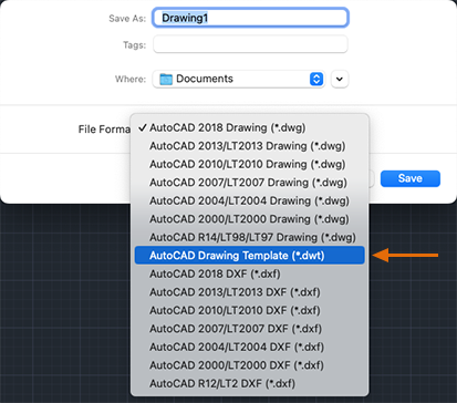

You can save any drawing (.dwg) file as a drawing template (.dwt) file. To create a drawing template file based on an existing one, open the existing drawing template file, modify it, and then save it with a different filename.

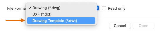

If you work independently, you can develop your drawing template files to suit your working preferences, adding settings for additional features as you become familiar with them. To modify an existing drawing template file, click Open, specify Drawing Template (*.dwt) in the dialog box, and choose the template file.

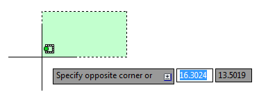

Press Esc to cancel this preselection operation.
