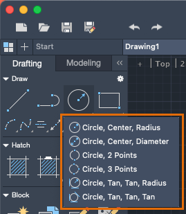

The default option of the CIRCLE command requires you to specify a center point and a radius.
Additional circle options are available from the drop-down:
Alternatively, you can also enter CIRCLE or just C in the Command window and specify an option.

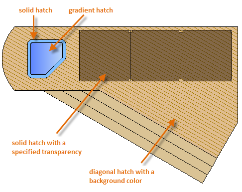

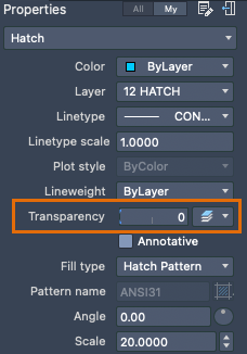

If you set a hatch pattern to be a solid or gradient fill, also consider setting a transparency level for interesting overlap effects. To set the transparency, select the hatch object and adjust the slider on the Properties Inspector.
Note: The Properties Inspector is covered in the Properties topic.
Here are some examples of how you can use solid-fill hatches:

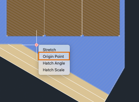

If you need to align the pattern in a hatch, which might be the case with the decking boards above, hover over the hatch's origin grip, and select Origin Point to specify an alignment point.

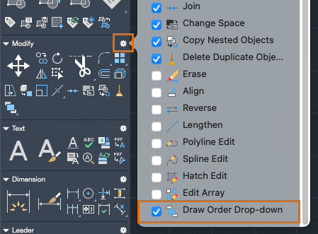

For overlapping hatches, fills, wide polylines, and text objects, use the DRAWORDER command to determine which objects are on top or below the others. For example, you probably want the yellow highway to cross the blue river rather than the other way around.
You can access several draw order options from the Modify panel on the tool set. Click on the Modify panel and select to display the Draw Order drop-down.
Expand the drop-down to see draw order options including sending all hatches to the back, selected objects to the front, and so on.
The drop-down list displays options for selected objects plus options that apply to all objects of a certain type, such as text.
