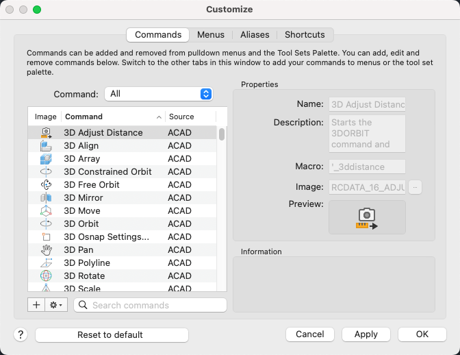

Creates and manages the available commands that can be added to menus.
CUI (Command)
Menu: .
The following options are displayed.
Displays all the standard and custom commands available.
Adds a new command to the Commands list that can be added to the menus.
Displays a menu which allows you to manage existing commands in the Commands list.
Filters the commands displayed in the Commands list. Click the ‘X’ in the text box to clear the current filter.
Enter a text string to control which commands are displayed in the Commands list. Only the names of the commands that contain the text string are displayed in the Commands list.
Displays the properties and values that define the selected command in the Command list.
Displays the name of the command. The name you enter is the label or tooltip name displayed in the program.
Displays the description for the command. The description you enter is displayed in a tooltip.
Displays the macro assigned to the command. Enter a new or change the existing macro for the command.
Specifies the raster image to use for the command when it is added to a tool set.
Displays a thumbnail of the image currently assigned to the command.
Displays some basic information about the field that currently has cursor focus under Properties.
Resets the commands and user interface elements back to their initial installed default settings.
