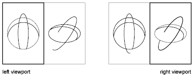

Project
Specifies the projection method used when extending objects.

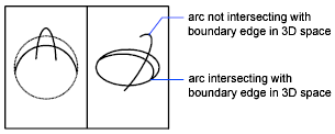

None
Specifies no projection. Only objects that intersect with the boundary edge in 3D space are extended.

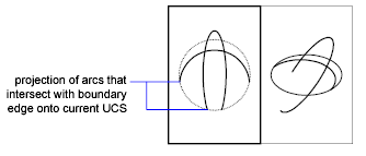

UCS
Specifies projection onto the XY plane of the current user coordinate system (UCS). Objects that do not intersect with the boundary objects in 3D space are extended.
View
Specifies projection along the current view direction.
Edge
Extends the object to another object's implied edge, or only to an object that actually intersects it in 3D space.
Extend
Extends the boundary object along its natural path to intersect another object or its implied edge in 3D space.
No Extend
Specifies that the object is to extend only to a boundary object that actually intersects it in 3D space.
