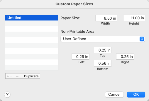

PLOT (Command)
Toolbar:
: Paper Size: Manage Custom Sizes
- Paper Size List
- Lists the existing custom paper sizes by name.
. Adds a new paper size.
. Removes the selected paper size.
- Duplicate. Copies the selected paper size to create a custom paper size that you can edit.
- Paper Size
- Defines the width and height for the custom paper size.
- Non-Printable Area
- Defines the margins for the custom paper size.
