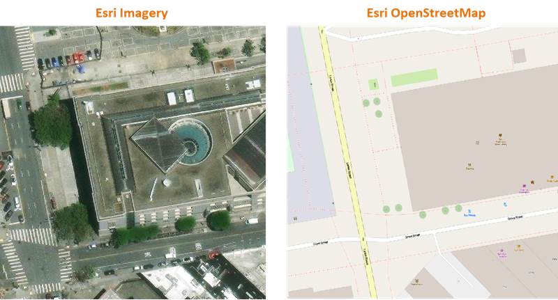

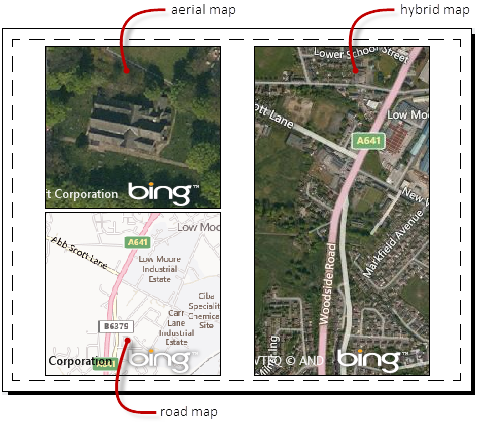

You can display the map as a satellite image (Esri Imagery) or as a vector image (Esri OpenStreetMap). If the drawing area is divided into multiple viewports, each viewport can have a different style of map.
