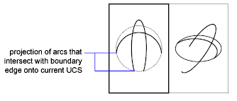

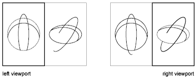

Specifies the projection method used when extending objects.
Specifies no projection. Only objects that intersect with the boundary edge in 3D space are extended.
Specifies projection onto the XY plane of the current user coordinate system (UCS). Objects that do not intersect with the boundary objects in 3D space are extended.
Specifies projection along the current view direction.

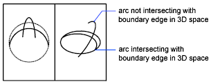

Extends the object to another object's implied edge, or only to an object that actually intersects it in 3D space.
Extends the boundary object along its natural path to intersect another object or its implied edge in 3D space.
Specifies that the object is to extend only to a boundary object that actually intersects it in 3D space.
