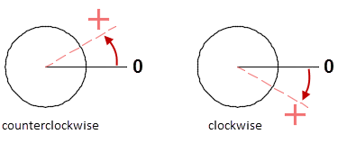

- Measure angles clockwise?
-  Specifies the direction of positive angles from angle 0.
