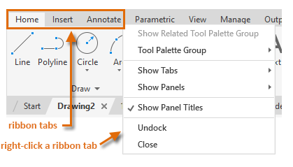

To Undock the Ribbon
- Right-click the ribbon tabs and select undock.

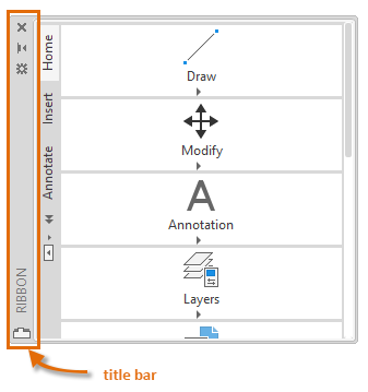

To Dock the Ribbon in a New Location
- If it is not undocked, undock the ribbon
- Click the title bar and drag the undocked ribbon to either the left edge, right edge, or top of the drawing area
- When the outline of the window is displayed in the docking area, release the button
Note: To return the ribbon to its previous location, double-click the title bar.
